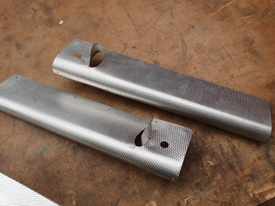

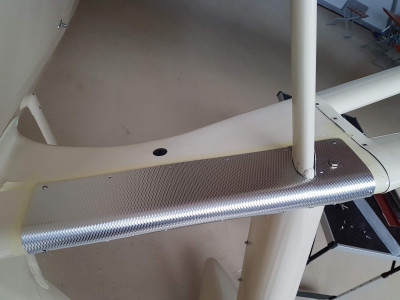

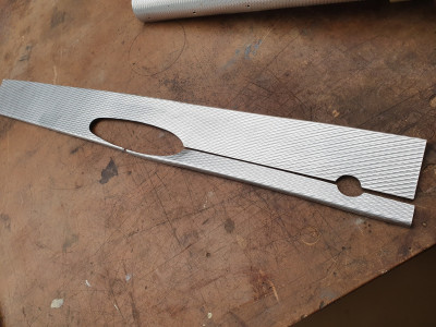

For the restoration of our own F-24 R46A, we had some sheets of the original material of the embossed aluminum panels made. We had to make a molding for the arched sheets on the wheel pants to bring them into the correct form.
We can offer a set of two arched sheets for the wheel pants for $240.00 or a complete set for the aircraft for: $420.00 which includes:
2 sheets for the treadplates
2 sheets for the wing struts
2 arched sheets for the wheel pants
Some sheet material for the small triangles in front of the treadplates.
Pictures are available.

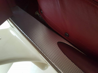

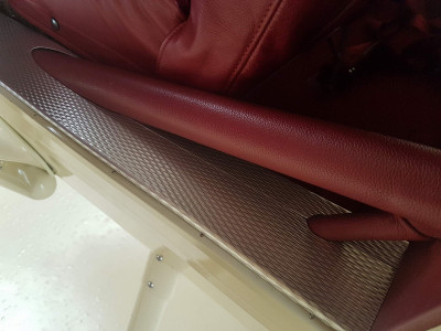

Hello Jim,
sounds good. To explain: In 2018 we searched all over the world and couldn´t find the original correctly embossed aluminium sheet material.
For this reason we placed a special order with a company in UK. But we had to order at least three 98" x 49" sheets!
Still have enough material for lots of F-24´s!
Enclosing pictures of the finished panels.
Please contact us by email: info@classicaviation.de
Manfred
