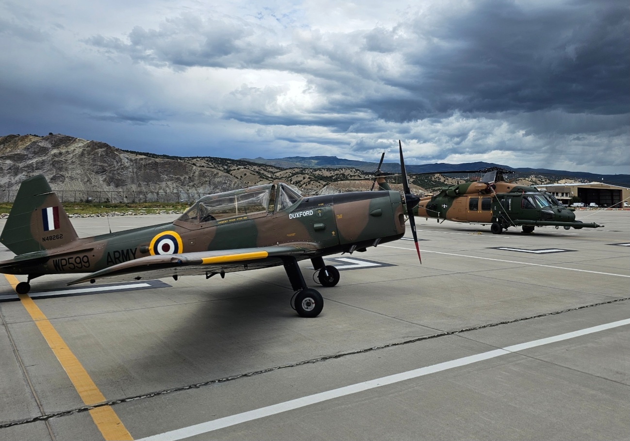

Thanks Jlevine. We are running a 200 hp Ranger in a Chipmunk. We also fly a Yak 52 and an N3N-3. The Yak and the N3N we run straight 60 weight and it makes a noticeable difference in how much oil gets thrown out. Carbonizing the rings in the M-14 or the R-985 has not been a problem, but the 25-60 for the Ranger sounds smart. Good luck with getting the 24! They are very cool old airplanes!! 😁. M.C.
Ranger powered DHC-1
